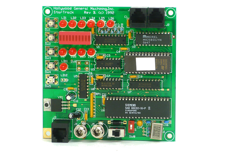

Este modelul LVI 1 care nu este compatibil cu Losmandy #492 fiindca acesta trimite corectiile catre montura simultan pe RA si DEC. Iar electronica de la Losmandy #492 nu poate primi comenzi in acelasi timp pe ambele axe. De aici si problema care a fost rezolvata cu modelul LVI 2 printr-o simpla comanda prin care se trimit comenzile pe rand.

Pe de alta parte, Losmandy #492 Digital Drive Controller dateaza de prin 1992 avand o clona de 8051 (SAB 80C32) cu UV EPROM. Nici aici nu cred ca putem vorbi de firmware update.

If you want to use a SmartGuider with a G11, you'll need to upgrade to a recent Gemini kit or buy a SmartGuider 2. If you have an earlier SmartGuider or Solitaire you're pretty much up a creek if your main mount is a non Gemini Losmandy. Use it with another mount, sell it for what you can get on AstroMart and buy a SmartGuider 2 from Herb, or install a Gemini retrofit kit.
