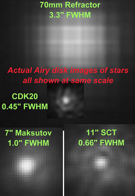

Am gasit explicatia pentru care refractoarele PAR a avea imagini mai bune decat reflectoarele mari:
"Actual comparison of Airy patterns from several telescopes of different apertures, all shown at the same arc-second scale. Note that the small refractor and Maksutov have well-shaped diffraction patterns that make the stars look good, but the angular size of the stars is much larger than the telescopes with greater aperture. This is a direct recording of the likely reason that refractors appear to out-peform larger aperture SCT's."

11"SCT - 0.66" FWHM

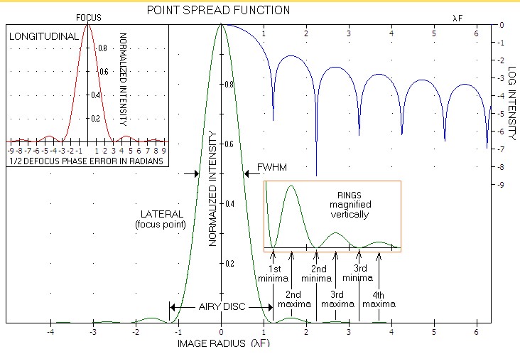

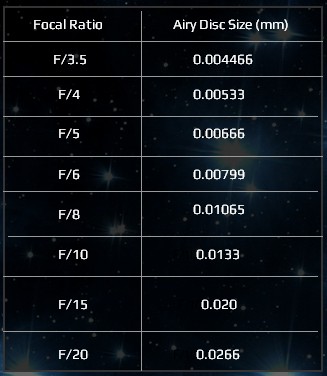

trebuie sa pornim de la faptul ca stelele nu se pot vedea ca disc cu diametre diferite in functie de marimea stelei sau apropierea de noi oricat de mult le marim in limita puterii unui instrument existent . instrumentele in functie doar de deschidere ofera un airy disc in microni 4- 26 vizibil jos in poza tabel
iar FWHM (full width at half-maximum) in poza se vede. sigur in functie de diametrul obiectivului se obtin puteri de separare corespunzatoare dar limitati de seeing si mod de prelucrare .
in secunde arc se masoara distanta unghiulara intre doua stele nu marimea uneia singure.
