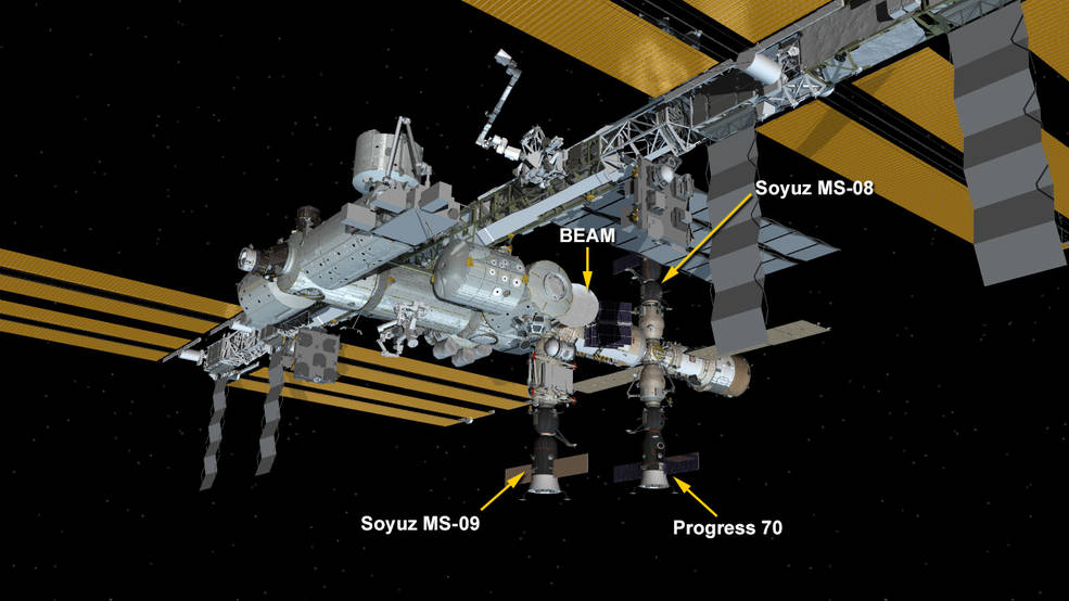

MesajTrimis: 05 Sep 2018 15:26 Download mesaj
NASA (August 30, 2018)
After a morning of investigations, the crew reported that the leak was isolated to a hole about two millimeters in diameter in the orbital compartment, or upper section, of the Soyuz MS-09 spacecraft attached to the Rassvet module of the Russian segment of the station.
Flight controllers at their respective Mission Control centers in Houston and Moscow worked together with the crew to effect a repair option in which Soyuz commander Sergey Prokopyev of Roscosmos used epoxy on a gauze wipe to plug the hole identified as the leak source. As the teams were discussing options, flight controllers in Moscow performed a partial increase of the station’s atmosphere using the ISS Progress 70 cargo ship’s oxygen supply. Flight controllers in Houston are continuing to monitor station’s cabin pressure in the wake of the repair.
https://blogs.nasa.gov/spacestation/2018/0...-status-3/
 Marime fisier:  72.89 kb
