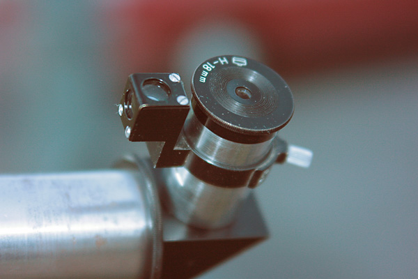

Dupa care,acelasi Chew adauga poza extremitatii oculare a mini-lunetei Nippon Kogaku ,spunand:
,,And that 18mm Nippon Kogaku eyepiece performed exceptionally well, as you'd expect.''
Nu trebuie sa studiezi prea mult poza pentru a-ti da seama ca vorbeste despre un ocular Nippon Kogaku de 18 mm focal si de tip Huygens.
