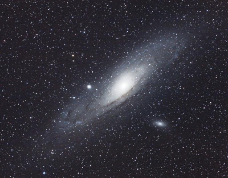

Uite niste poze ajutatoare:
1. Poza originala
2. Poza cu binning 2x2 (normalizata si rescalata)
3. Stack intre cele doua dupa metoda magica (renormalizata)
ORIGINAL
 Marime fisier:  93.99 kb
 Vizualizat:  de 6782 ori
BINNED
 Marime fisier:  71.19 kb
COM-BINNED
 Marime fisier:  71.77 kb

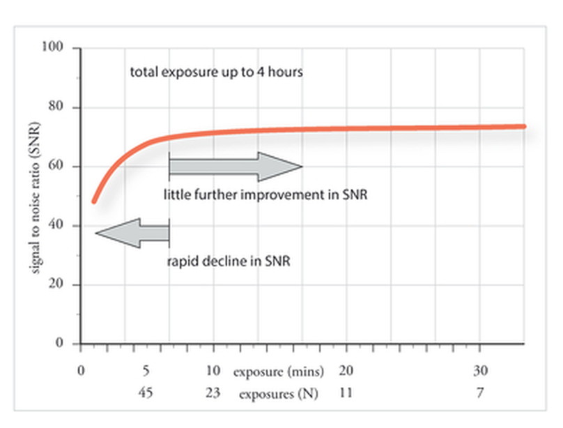

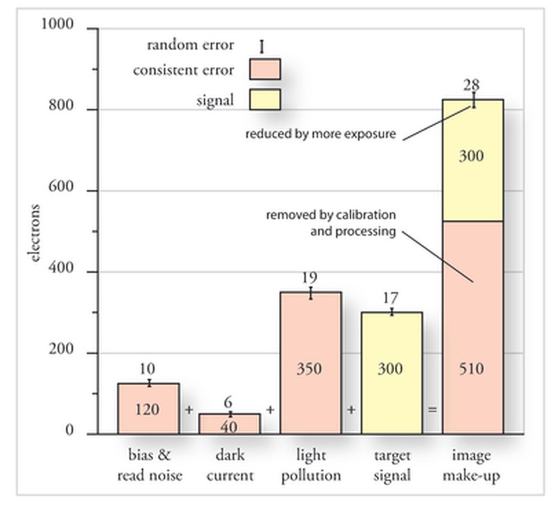

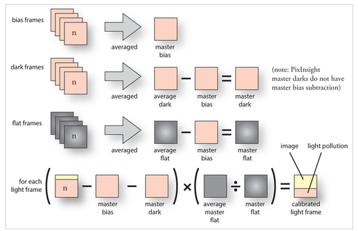

O idee ar fi citirea unei carti interesante, recent aparuta:
The Astrophotography Manual
A Practical and Scientific Approach to Deep Space Imaging
Chris Woodhouse
http://www.digitalastrophotography.co.uk/A.../Home.html
Cred ca este pentru toata lumea, de la incepatori pana la avansati.
O gasiti in format epub (sau pdf convertit) daca stiti unde sa o cautati (sau pm) Wink
Are si un mic paragraf numit "Object SNR and Binning".
There is an equally large and expanding choice in application software. This book tackles a wide range: including the latest image acquisition packages (including Sequence Generator Pro, Maxim DL, TheSkyX, Nebulosity and PHD2) as well as specialist image processing applications such as Maxim DL and PixInsight. PixInsight, in particular, is explained in detail to make up for its lack of official documentation. The book also discusses as many utilities and has several practical projects too, ideal for the summer months.
