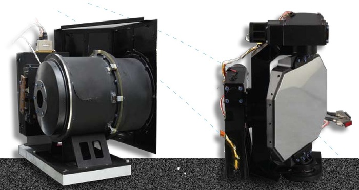

Stiti ce telescop au dus acolo?

150mm am auzit la un moment dat.

Citez:
One of the primary instruments of the lander is the Lunar-based Ultraviolet Telescope (LUT) that is used to observe galaxies, binary stars, active galactic nuclei and bright stars.
The LUT instrument sets out to perform multiple-day observation campaigns, looking at variable stars and active galaxies in the near-UV band. Objects that are bright in the NUV band include variable stars, binaries, novae, quasars and blazars. LUT will attempt to study the variability of these objects to examine the temperature and accretion rate in order to better understand stellar atmospheres and improve current models.
The LUT instrument consists of a Ritchey-Chretien telescope.
LUT has an aperture of 150mm and uses a pointing mirror that features a two-dimensional gimbal to track objects. A Charge-Coupled Device enhanced for observations in the ultraviolet band is used as detector. The CCD uses pixels 13 micrometers in size. LUT covers a wavelength range of 245 to 340 nanometers and is capable to detect objects at a brightness down to 13 mag.
Chang'e 3 - Mission Overview: http://www.spaceflight101.com/change-3.html
P.S. referitor la limita de 13 mag, am ceva dubii ...
LUT Subsystems: telescope body (left) & mounting platform with two-axis gimbal

Cam ciudat. Din descriere si fotografii inteleg ca nu au o montura care ghideaza telescopul, ci o oglinda plana mare, care se roteste in doua axe, si care ghideaza razele catre un telescop fix..De ce or fi ales sistemul asta, nu stiu.

@nobody 150mm f/3.5, mag. 13 limita la SNR 8 pt o expunere de 30s in UV cu un ccd E2V47-20, mi se pare rezonabil. http://arxiv.org/pdf/1108.0727.pdf

Din cate am inteles miscarea de rotatie a lunii e de cateva ori mai lenta decat a pamantului astfel, combinat cu timpi de expunere scurti probabil simplifica mult montura necesara. Sau poate au alte mecanisme mai eficiente pe acolo.

Intre timp, mi-a trecut prin cap o vaga amintire despre libratia Lunii, deci o miscare mai complexa decat cea a Pamantului. In plus, o oglinda e mai usoara decat un telescop, deci si montura oglinzii e mai usoara. Cam astea ar fi explicatiile pe care le-am gasit.

@auriga: Merci pentru document. Inteleg ca acea magnitutidne este o estimare destul de conservatoare. Ma asteptam la un pic mai mult, dar acum are sens.
auriga a scris:
